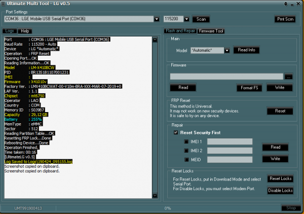

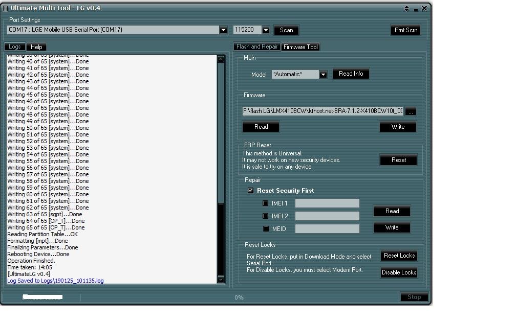

Reginaldo almeida Postado Janeiro 29, 2019 Compartilhar Postado Janeiro 29, 2019 X41010k LMX410BCWAT-00-V10f-BRA-XXX-SEP-06-2018+0 Flash feita com sucesso K11+ com UMT LG-v0.4 Roons aqui : https://www.clansoft.net/dl/index.php?a=downloads&b=search&in=&keyword=x410 Bruno Santana reagiu a isso 1 Citar Link para o comentário Compartilhar em outros sites More sharing options...

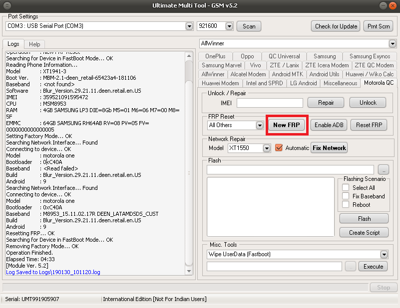

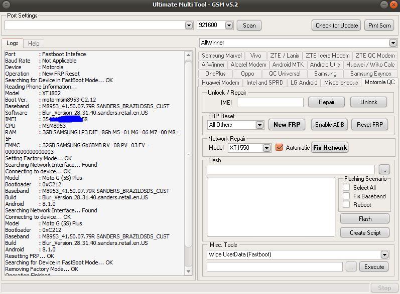

Rafael Marcolino da Silva Postado Janeiro 30, 2019 Compartilhar Postado Janeiro 30, 2019 MOTOROLA ONE ANDROID 9 Port : Fastboot Inteface Baud Rate : Not Applicable Device : Motorola Operation : New FRP Reset Searching for Device in FastBoot Mode... OK Reading Phone Information... Model : XT1941-3 Boot Ver. : MBM-2.1-deen_retail-65423a4-181106 Baseband : <not found> Software : Blur_Version.29.21.11.deen.retail.en.US IMEI : 359521091595472 CPU : MSM8953 RAM : 4GB SAMSUNG LP3 DIE=8Gb M5=01 M6=06 M7=00 M8=5F EMMC : 64GB SAMSUNG RH64AB RV=08 PV=05 FV=0000000000000005 Setting Factory Mode... OK Searching Network Interface... Found Connecting to device... OK Model : motorola one Bootloader : 0xC40A Baseband : <Read failed> Build : Blur_Version.29.21.11.deen.retail.en.US Android : 9 Searching Network Interface... Found Connecting to device... OK Model : motorola one Bootloader : 0xC40A Baseband : M8953_15.11.02.17R DEEN_LATAMDSDS_CUST Build : Blur_Version.29.21.11.deen.retail.en.US Android : 9 Resetting FRP... OK Searching for Device in FastBoot Mode... OK Removing Factory Mode... OK Operation Finished. Elapsed Time: 04:33 [Module Ver. 5.2] Log Saved to Logs\190130_101120.log Citar Link para o comentário Compartilhar em outros sites More sharing options...

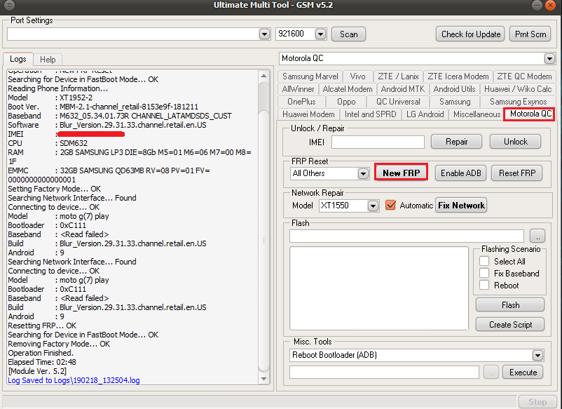

rafa81 Postado Fevereiro 18, 2019 Compartilhar Postado Fevereiro 18, 2019 FRP XT 1952-2 Moto G7 Play Citar Link para o comentário Compartilhar em outros sites More sharing options...

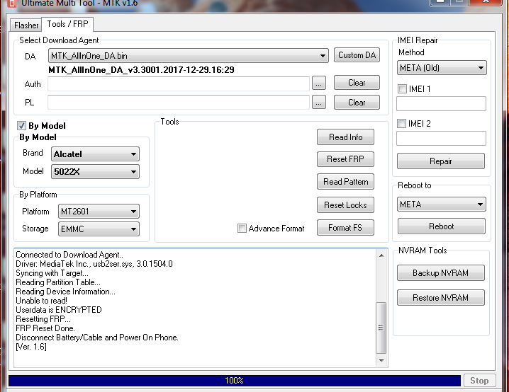

DADACEL CELULARES Postado Fevereiro 21, 2019 Compartilhar Postado Fevereiro 21, 2019 Frp Alcatel 4034E Android 6.0 Ferramenta : Ultimate Multi Tool - MTK v1.6 Obs: verifiquem que o modelo usado foi 5022x,mas o modelo do celular e 4034e Citar Link para o comentário Compartilhar em outros sites More sharing options...

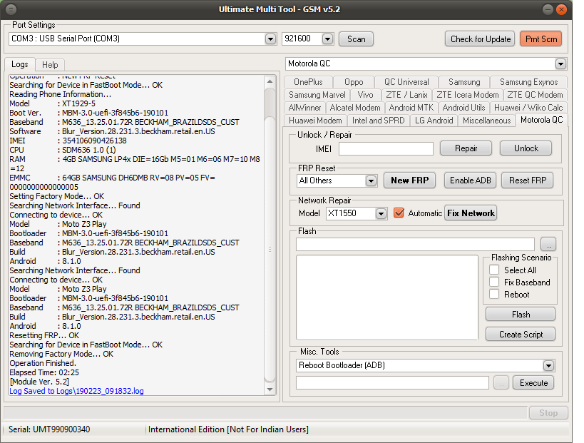

betowollacy Postado Fevereiro 23, 2019 Compartilhar Postado Fevereiro 23, 2019 FRP XT1929-5 UMT 8.1.0 Citar Link para o comentário Compartilhar em outros sites More sharing options...

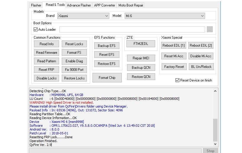

natanlinhares Postado Fevereiro 24, 2019 Compartilhar Postado Fevereiro 24, 2019 Em 28/09/2018 em 17:07, Reginaldo almeida disse: Mi phone MI 6 Android 8.0.0 patch de segurança 01/05/2018 versão do MIUI global 9.5 estável 9.5.8.0 ( OCAMIFA ) numero de modelo MCE16 IMG do TP ( test point ) amigo Reginaldo. após esse procedimento é possível colocar outra conta no mi account?? Citar Link para o comentário Compartilhar em outros sites More sharing options...

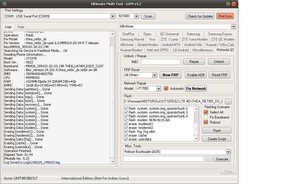

bryanfellipe Postado Fevereiro 25, 2019 Compartilhar Postado Fevereiro 25, 2019 FLASH XT1078 - Moto G2 4G Port : Fastboot Interface Baud Rate : Not Applicable Device : Motorola QC Operation : Flash Fw Model : thea_retbr_ds Fw Version : thea_retbr_ds-user 6.0 MPBS24.65-34-5 7 release-keysM8926_309101.02.03.19R Searching for Device in FastBoot Mode... OK Reading Phone Information... Model : XT1078 Boot Ver. : 4822 Baseband : M8926_309101.02.03.19R THEA_LATAM_DSDS_CUST Software : Blur_Version.24.201.5.thea_retbr_ds.retbr.en.BR IMEI : **************** CPU : MSM8926 RAM : 1024MB Elpida S4 SDRAM DIE=4Gb EMMC : 16GB ID=15 REV=07 PRV=01 TYPE=57 Sending Data [partition]... Done Sending Data [motoboot]... Done Sending Data [logo]... Done Sending Data [boot]... Done Sending Data [recovery]... Done Sending Data [system]... Done Sending Data [system]... Done Sending Data [system]... Done Sending Data [system]... Done Sending Data [system]... Done Sending Data [modem]... Done Erasing [modemst1]... Done Erasing [modemst2]... Done Sending Data [fsg]... Done Erasing [cache]... Done Erasing [userdata]... Done Operation Finished. Elapsed Time: 01:44 [Module Ver. 5.2] Citar Link para o comentário Compartilhar em outros sites More sharing options...

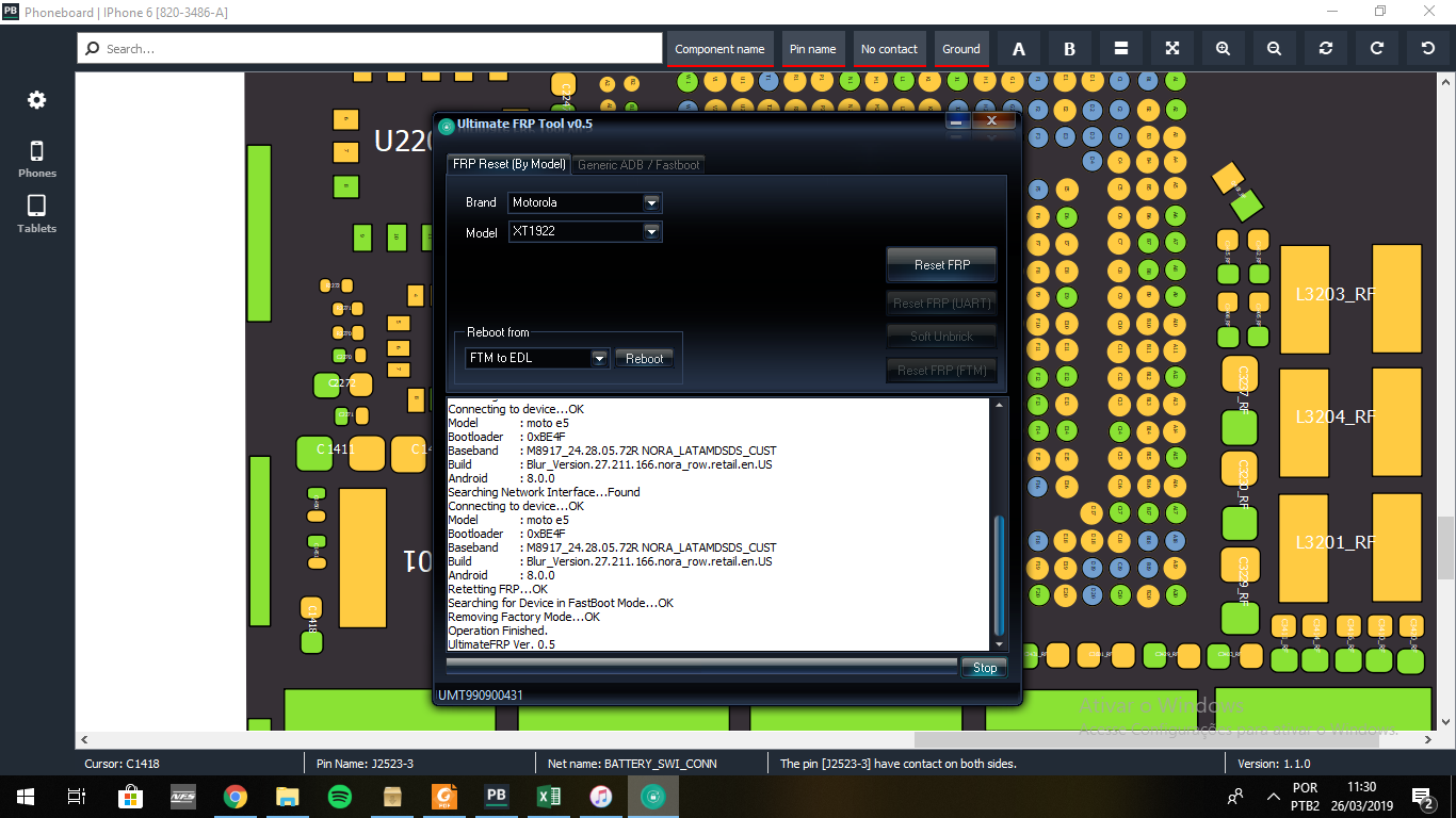

Emilio cell PE Postado Março 26, 2019 Compartilhar Postado Março 26, 2019 MOTO E5 FRP Citar Link para o comentário Compartilhar em outros sites More sharing options...

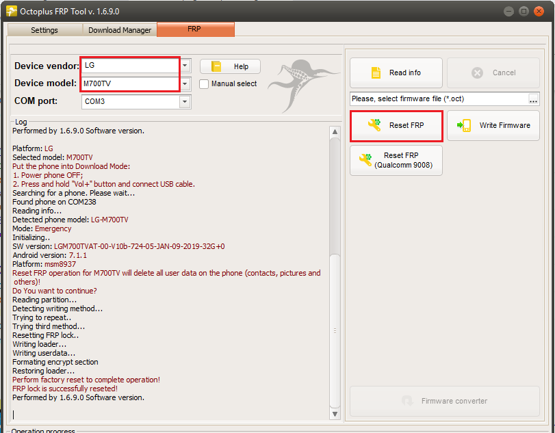

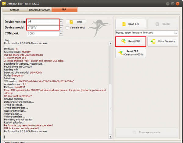

rafa81 Postado Abril 4, 2019 Compartilhar Postado Abril 4, 2019 FRP LG M700TV Q6 Citar Link para o comentário Compartilhar em outros sites More sharing options...

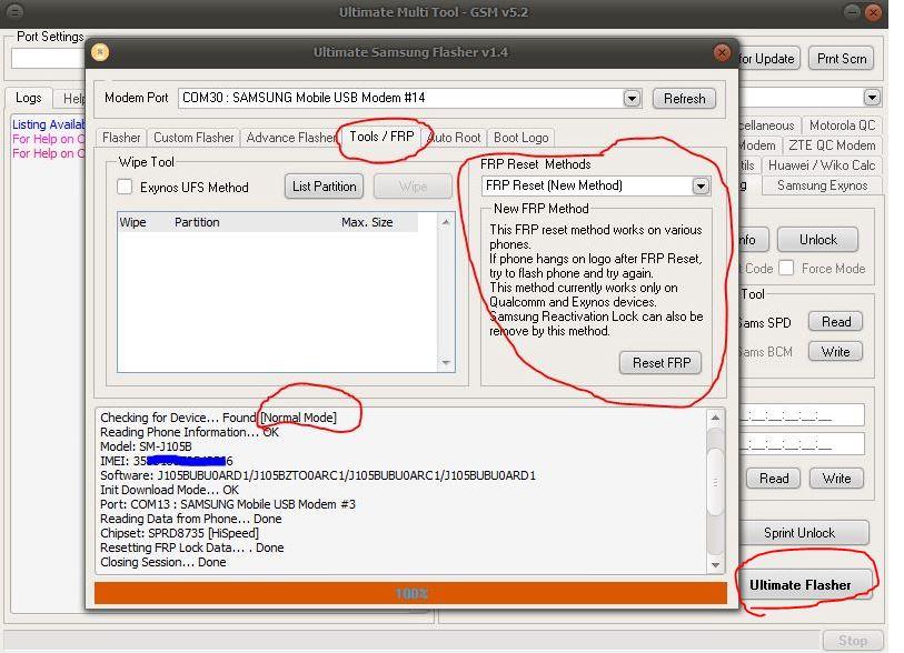

Pedro - BIVOLT CELL Postado Abril 12, 2019 Compartilhar Postado Abril 12, 2019 FRP J105B, DONE Citar Link para o comentário Compartilhar em outros sites More sharing options...

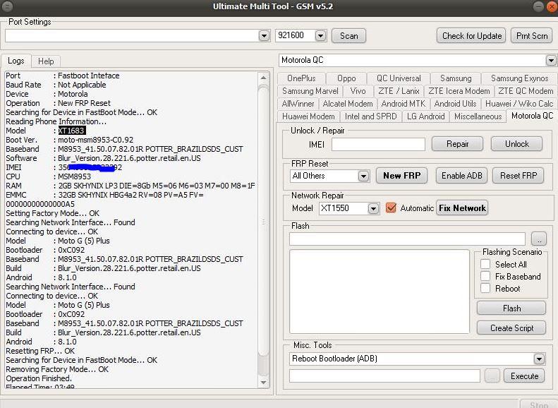

Pedro - BIVOLT CELL Postado Abril 12, 2019 Compartilhar Postado Abril 12, 2019 FRP MOTO G5 PLUS, XT1683, DONE. Citar Link para o comentário Compartilhar em outros sites More sharing options...

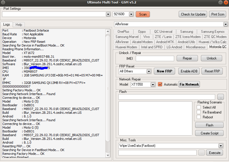

Pedro - BIVOLT CELL Postado Abril 12, 2019 Compartilhar Postado Abril 12, 2019 FRP MOTO G5 , XT1672, DONE. Citar Link para o comentário Compartilhar em outros sites More sharing options...

Hunnoren Postado Abril 24, 2019 Compartilhar Postado Abril 24, 2019 FRP LG K11+ ANDROID 7.1.2 Pach de segurança 1 de março de 2019 Ultimate mult tool LG V0.5 Cristiano de Moraes e Reginaldo almeida reagiu a isso 2 Citar Link para o comentário Compartilhar em outros sites More sharing options...

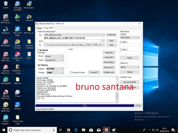

Bruno Santana Postado Maio 4, 2019 Autor Compartilhar Postado Maio 4, 2019 frp multilaser ms50g Reginaldo almeida, jbcelular, 123adilson e 1 outro reagiu a isso 4 Citar Link para o comentário Compartilhar em outros sites More sharing options...

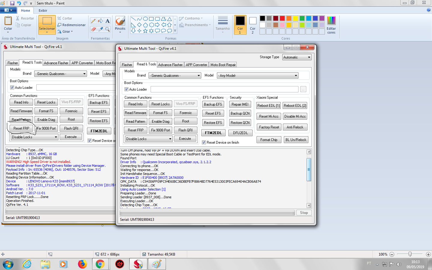

Hunnoren Postado Maio 9, 2019 Compartilhar Postado Maio 9, 2019 FRP LENOVO VIBE K6 K33A48 Pach 1 de novembro android 7.0 Cristiano de Moraes reagiu a isso 1 Citar Link para o comentário Compartilhar em outros sites More sharing options...

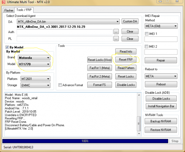

Hunnoren Postado Maio 10, 2019 Compartilhar Postado Maio 10, 2019 FRP MOTO E4 XT1763 thalys reagiu a isso 1 Citar Link para o comentário Compartilhar em outros sites More sharing options...
