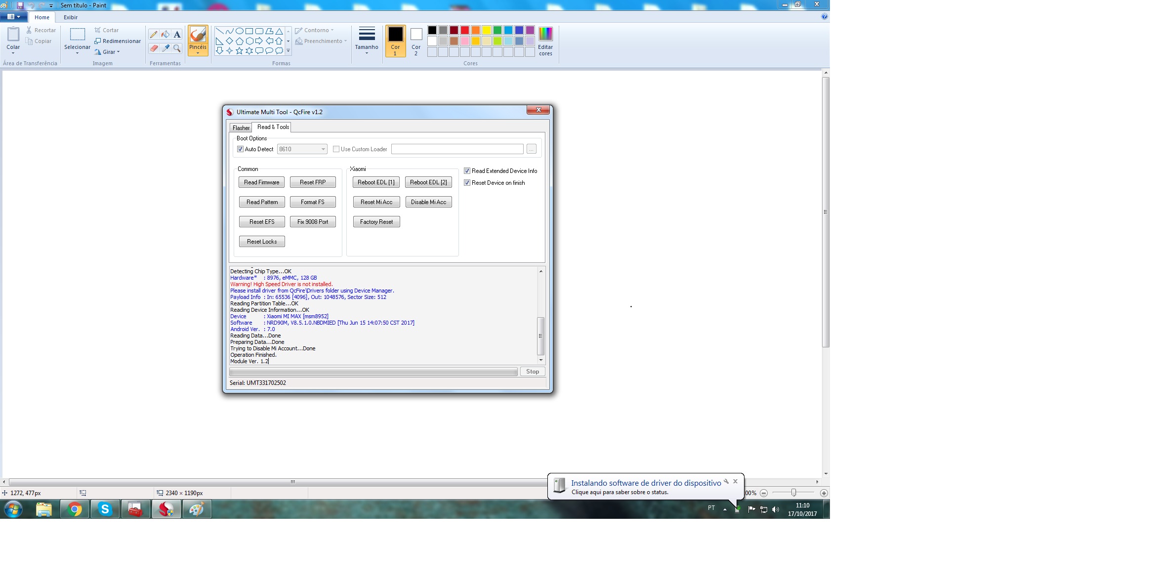

Reginaldo almeida Postado Outubro 17, 2017 Compartilhar Postado Outubro 17, 2017 Xiaomi MI MAX ( msm8952 ) 100% Bruno Santana reagiu a isso 1 Citar Link para o comentário Compartilhar em outros sites More sharing options...

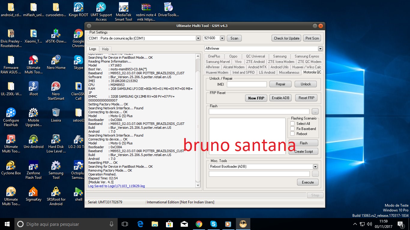

Bruno Santana Postado Novembro 3, 2017 Autor Compartilhar Postado Novembro 3, 2017 moto g5 frp 100% Reginaldo almeida reagiu a isso 1 Citar Link para o comentário Compartilhar em outros sites More sharing options...

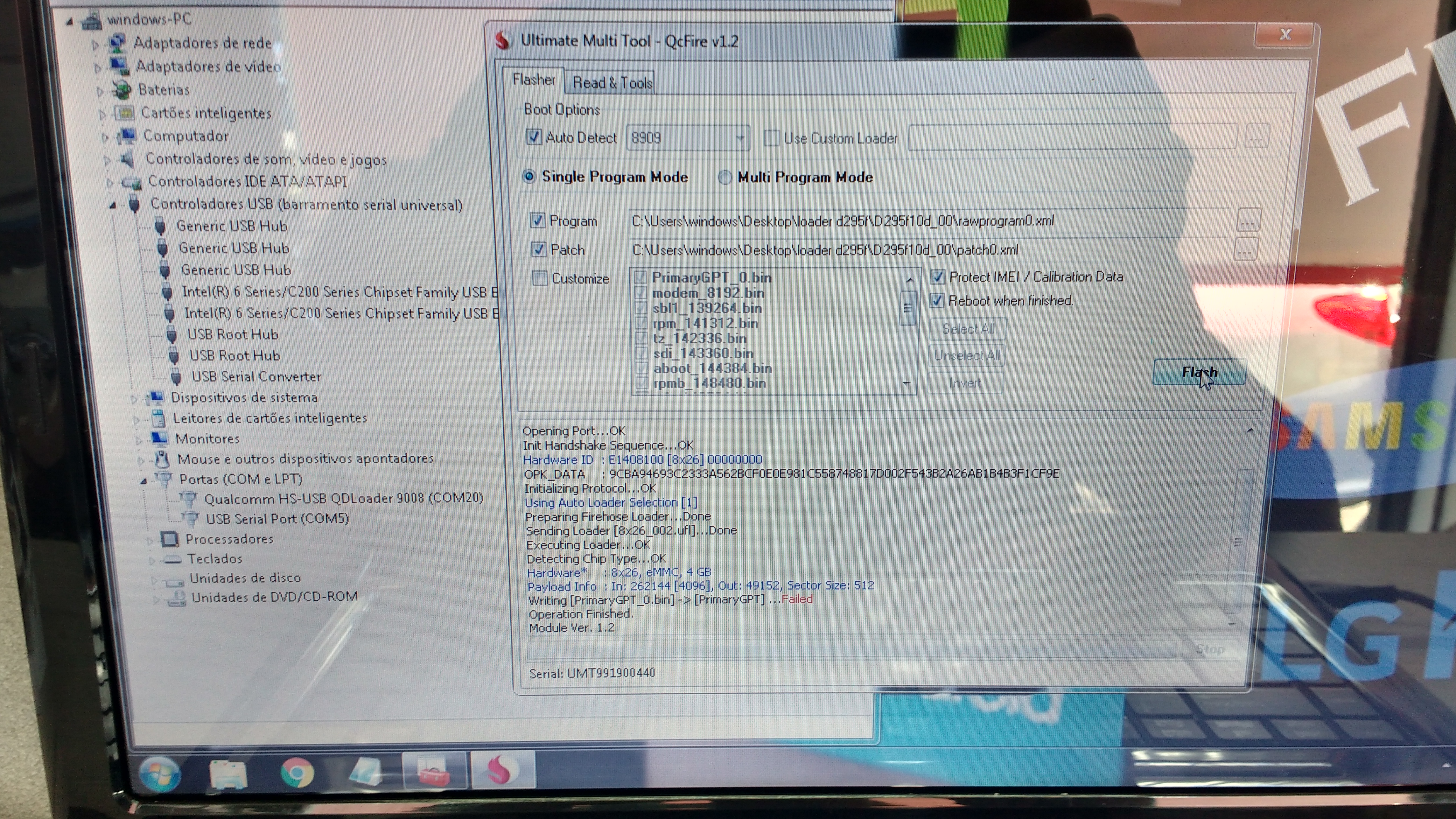

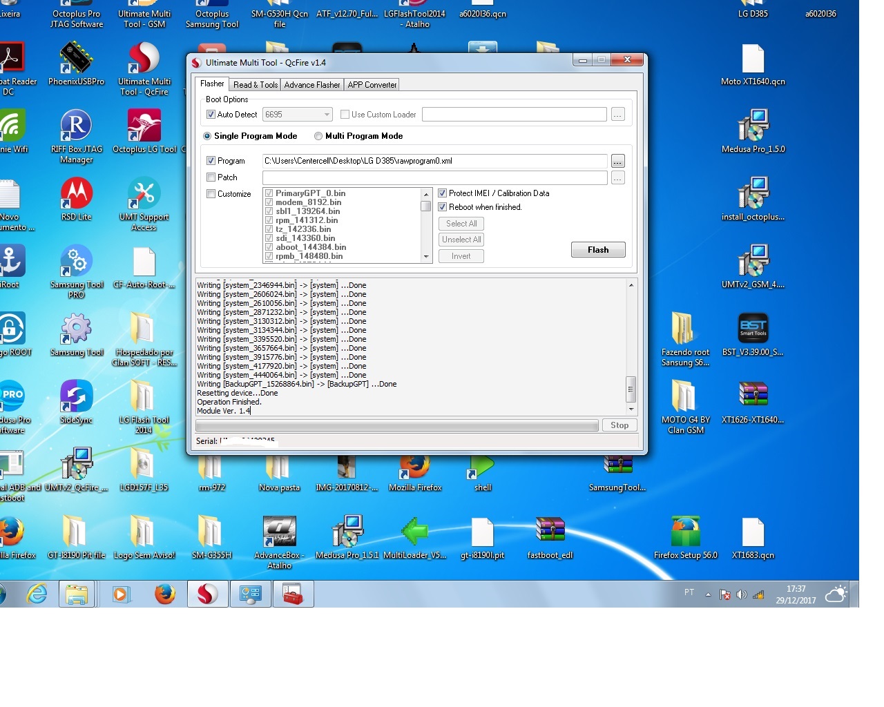

ProInfoCell Postado Novembro 13, 2017 Compartilhar Postado Novembro 13, 2017 Em 22/06/2017 em 17:32, Bruno Santana disse: D295 e D295F Dead boot repair (no modo qsdload) 100% Operation : Flash Checking for existing devices... Not Found Turn Off phone, hold Vol UP + Vol DOWN and insert USB cable. Found Port : Qualcomm HS-USB QDLoader 9008 (COM21) Driver Info : Qualcomm Incorporated, qcusbser.sys, 2.1.2.2 Connecting to phone... OK Waiting for response... OK Init Handshake Sequence... OK Hardware ID : E1408100 [8610] 00000000 Initializing Protocol... OK Using Auto Selection Preparing Firehose Loader... Done Sending Loader [8610.ufl]... Done Executing Loader... OK Hardware : 8x26, eMMC, 2 GB Warning! High Speed Driver not installed. Please install driver from QcFire\Drivers folder. Payload Info : In: 65536 [4096], Out: 49152, Sector Size: 512 Writing [PrimaryGPT_0.bin] -> [PrimaryGPT] ... Done Writing [modem_8192.bin] -> [modem] ... Done Writing [sbl1_139264.bin] -> [sbl1] ... Done Writing [rpm_141312.bin] -> [rpm] ... Done Writing [tz_142336.bin] -> [tz] ... Done Writing [sdi_143360.bin] -> [sdi] ... Done Writing [aboot_144384.bin] -> [aboot] ... Done Writing [rpmb_148480.bin] -> [rpmb] ... Done Writing [tzb_149504.bin] -> [tzb] ... Done Writing [abootb_150528.bin] -> [abootb] ... Done Writing [persist_204800.bin] -> [persist] ... Done Writing [laf_270336.bin] -> [laf] ... Done Writing [boot_319488.bin] -> [boot] ... Done Writing [recovery_364544.bin] -> [recovery] ... Done Writing [factory_475136.bin] -> [factory] ... Done Writing [sbl1b_581632.bin] -> [sbl1b] ... Done Writing [cust_655360.bin] -> [cust] ... Done Writing [BackupGPT_7633920.bin] -> [BackupGPT] ... Done Applying Patches... Done Resetting device... Done Operation Finished. D295f10d_00.rar D295.rar o meu da um erro PRIMARY GPT_0.BIN...PRIMARYGPT FAILED Citar Link para o comentário Compartilhar em outros sites More sharing options...

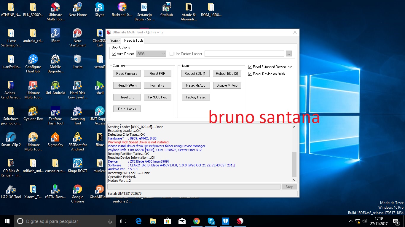

Bruno Santana Postado Novembro 27, 2017 Autor Compartilhar Postado Novembro 27, 2017 frp ZTE Blade A460 Reginaldo almeida e jbcelular reagiu a isso 2 Citar Link para o comentário Compartilhar em outros sites More sharing options...

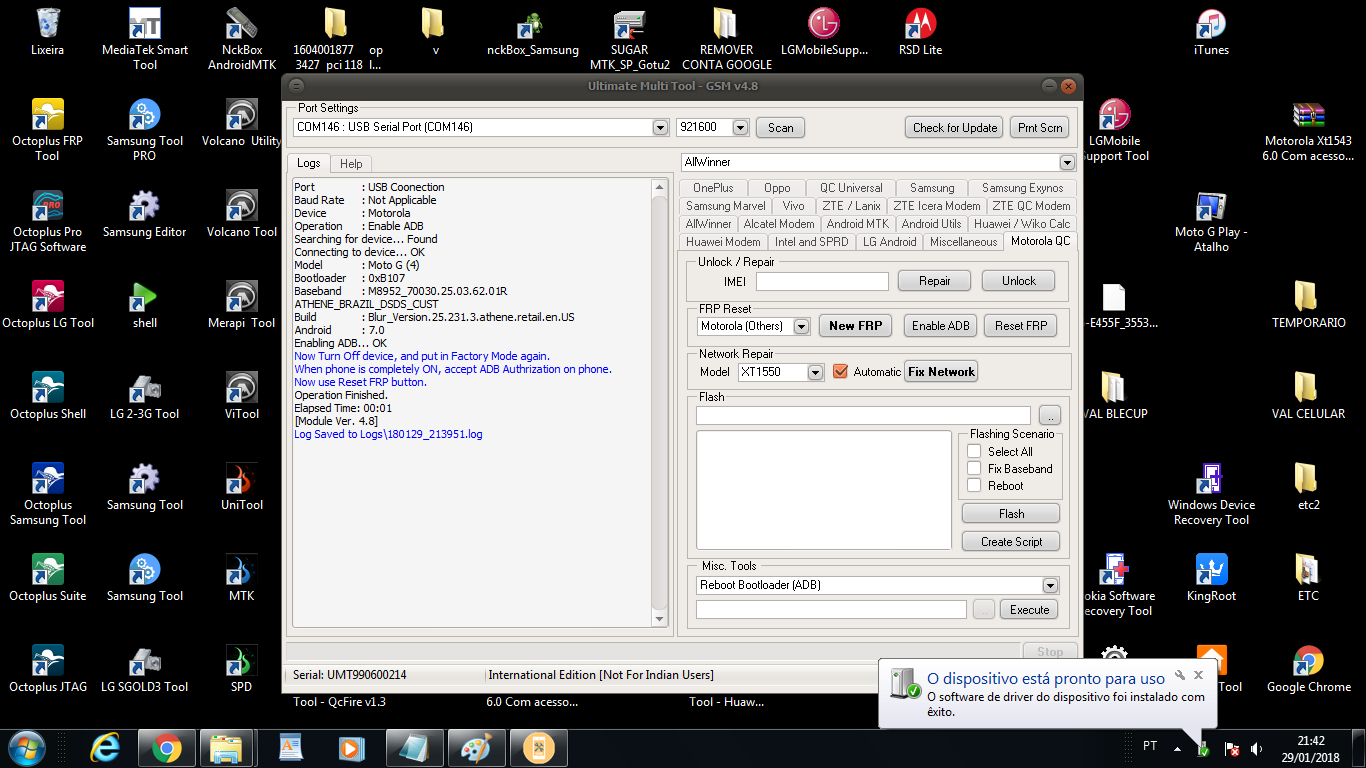

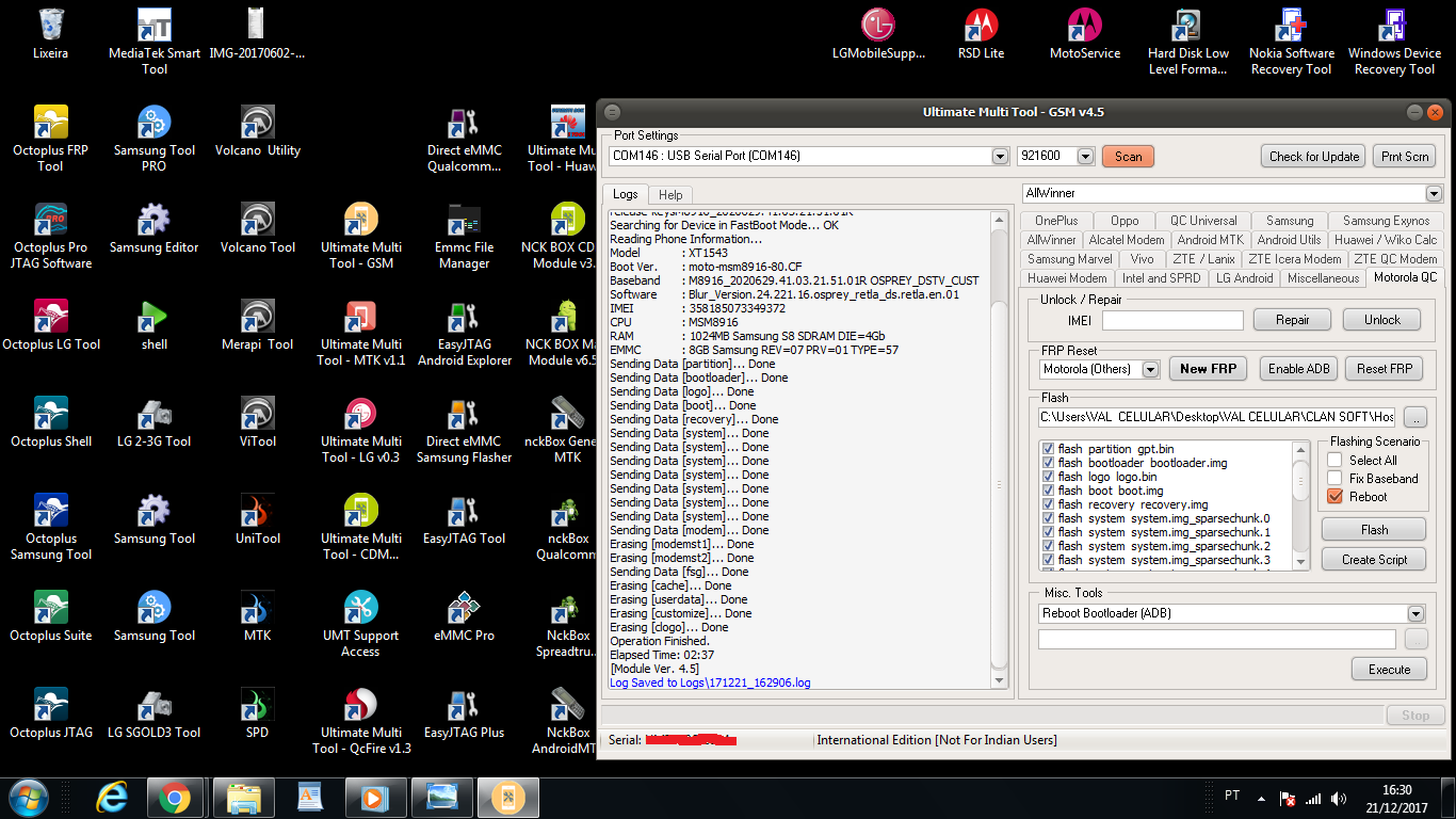

VAL CELULAR Postado Dezembro 21, 2017 Compartilhar Postado Dezembro 21, 2017 flash com sucesso no moto g3 xt1543 com a umt box!!! Citar Link para o comentário Compartilhar em outros sites More sharing options...

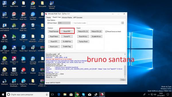

Bruno Santana Postado Dezembro 27, 2017 Autor Compartilhar Postado Dezembro 27, 2017 reset frp lenovo vibe k5 a6020l36 nesse metodo nao perde wifi Operation : Reset FRP Checking for existing devices...Not Found Turn Off phone, hold Vol UP + Vol DOWN and insert USB cable. Some phones may need Special Boot Cable or TestPoint for EDL mode. Found Port : Qualcomm HS-USB QDLoader 9008 (COM21) Driver Info : Lenovo Inc., leusbser.sys, 2.0.9.6 Connecting to phone...OK Waiting for response...OK Init Handshake Sequence...OK Hardware ID : E1B09000 [8936] 01000100 OPK_DATA : 5F5DBD11259E7F99680B3D60E74EC73BDD5387694EA6D96CBF808A68A7369E82 Initializing Protocol...OK Using Auto Loader Selection [1] Preparing Firehose Loader...Done Sending Loader [8936_004.ufl]...Done Executing Loader...OK Detecting Chip Type...OK Hardware* : 8936, eMMC, 16 GB Warning! High Speed Driver is not installed. Please install driver from QcFire\Drivers folder using Device Manager. Payload Info : In: 65536 [4096], Out: 16384, Sector Size: 512 Reading Partition Table...OK Reading Device Information...OK Device : LENOVO Lenovo A6020l36 [msm8916] Software : A6020l36_S032_160401_LAS, A6020l36_S032_160401_LAS [2016å¹´ 04月 01æ—¥ 星期五 17:25:14 CST] Android Ver. : 5.1.1 Resetting FRP Lock......Done Operation Finished. Module Ver. 1.4 Reginaldo almeida e 123adilson reagiu a isso 2 Citar Link para o comentário Compartilhar em outros sites More sharing options...

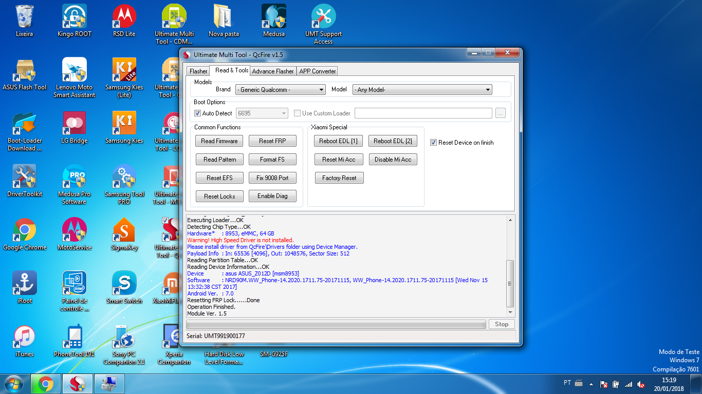

William Ferreira Postado Janeiro 9, 2018 Compartilhar Postado Janeiro 9, 2018 Remoção de conta Google Asus ZenFone 4 Selfie Pro Z01MD Operation : Reset FRP Checking for existing devices...Found Port : COM97 Opening Port...OK Init Handshake Sequence...OK Hardware ID : E1600400 [8953] 53893A14 OPK_DATA : 488BC976FD1296EB66F33F733D31DE27D8D2FDD04D372181223CA9837E888597 Initializing Protocol...OK Using Auto Loader Selection [1] Preparing Firehose Loader...Done Sending Loader [8953_006.ufl]...Done Executing Loader...OK Detecting Chip Type...OK Hardware* : 8953, eMMC, 32 GB Warning! High Speed Driver is not installed. Please install driver from QcFire\Drivers folder using Device Manager. Payload Info : In: 65536 [4096], Out: 1048576, Sector Size: 512 Reading Partition Table...OK Reading Device Information...OK Device : asus ASUS_Z01MD [msm8953] Software : NMF26F.WW_user_12.40.273.84_20171107, WW_Z01M-WW_user_12.40.273.84_20171107-user-20171107 [Tue Nov 7 02:33:38 CST 2017] Android Ver. : 7.1.1 Resetting FRP Lock......Done Operation Finished. Reginaldo almeida reagiu a isso 1 Citar Link para o comentário Compartilhar em outros sites More sharing options...

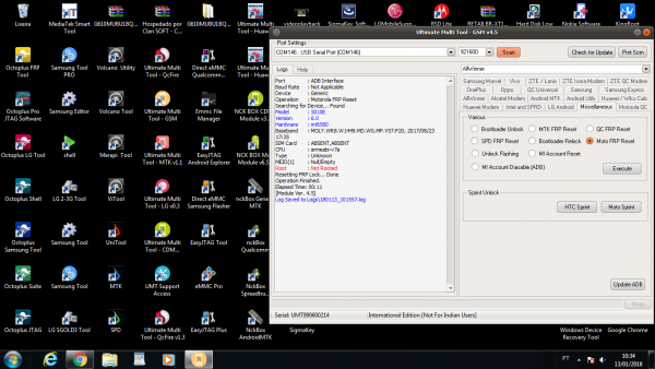

VAL CELULAR Postado Janeiro 13, 2018 Compartilhar Postado Janeiro 13, 2018 ALCATEL 5010E PIIXE 4 reset frp Reginaldo almeida reagiu a isso 1 Citar Link para o comentário Compartilhar em outros sites More sharing options...

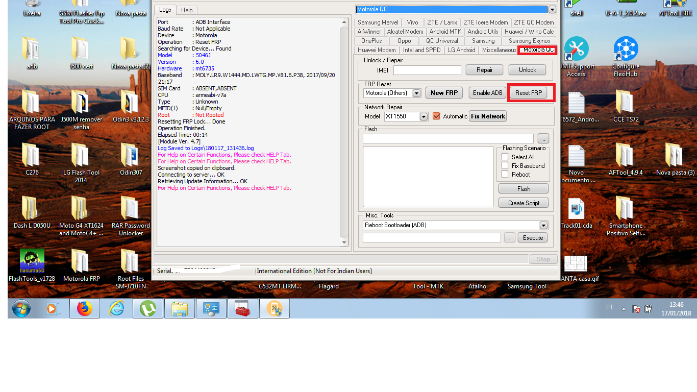

ToninhoSantos Postado Janeiro 17, 2018 Compartilhar Postado Janeiro 17, 2018 Alcatel 5046J frp done Coloque o aparelho em recovery e selecione " reboot to bootloader" Após iniciar habiltar a depuração USB e seguir os passos abaixo no print. Anderson Alves, 123adilson e Bruno Santana reagiu a isso 3 Citar Link para o comentário Compartilhar em outros sites More sharing options...
Cristiano de Moraes Postado Janeiro 19, 2018 Compartilhar Postado Janeiro 19, 2018 (editado) Remoção FRP ZD553kl ASUS Agradeço ao amigo Reginaldo almeida pela ajuda. Editado Janeiro 19, 2018 por Cristiano de Moraes Reginaldo almeida, William Ferreira e VAL CELULAR reagiu a isso 3 Citar Link para o comentário Compartilhar em outros sites More sharing options...

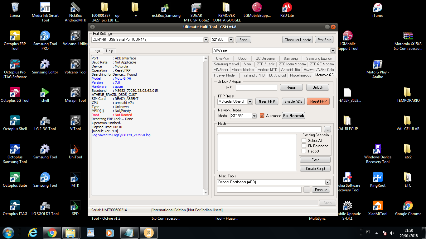

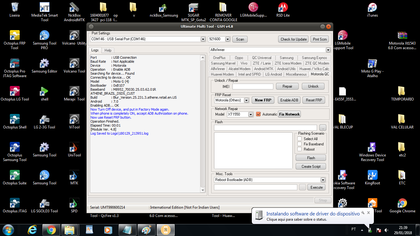

VAL CELULAR Postado Janeiro 30, 2018 Compartilhar Postado Janeiro 30, 2018 Moto G4 plus XT1640 com a Versão do android 7.0 de 1 de dezembro de 2017 FRP com Sucesso com a UMT box!!! Reginaldo almeida reagiu a isso 1 Citar Link para o comentário Compartilhar em outros sites More sharing options...

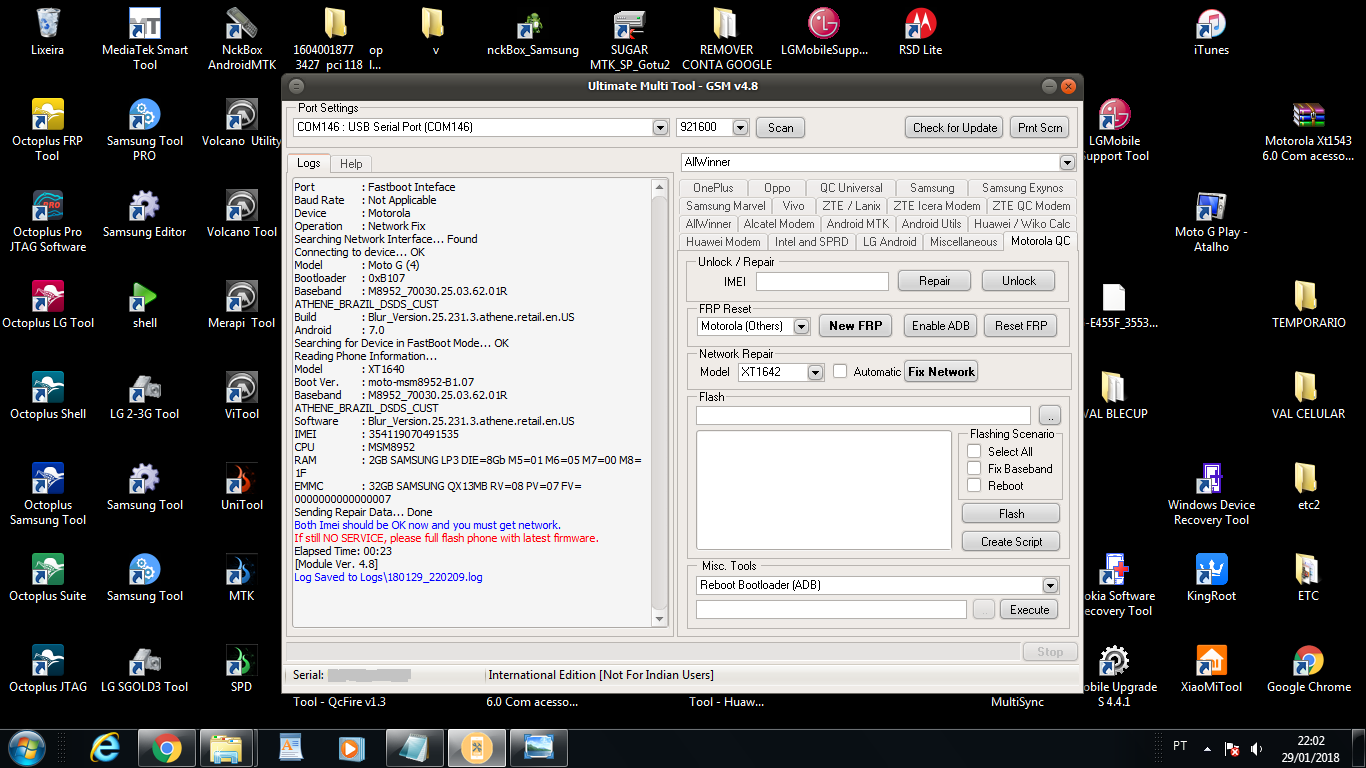

VAL CELULAR Postado Janeiro 30, 2018 Compartilhar Postado Janeiro 30, 2018 ( Network ) com Sucesso no moto g4 plus xt1640 com a UMT box !!! apos feito o desbloqueio frp o atc não subiu mais área. Fica direto sem serviço. Reginaldo almeida e ToninhoSantos reagiu a isso 2 Citar Link para o comentário Compartilhar em outros sites More sharing options...
