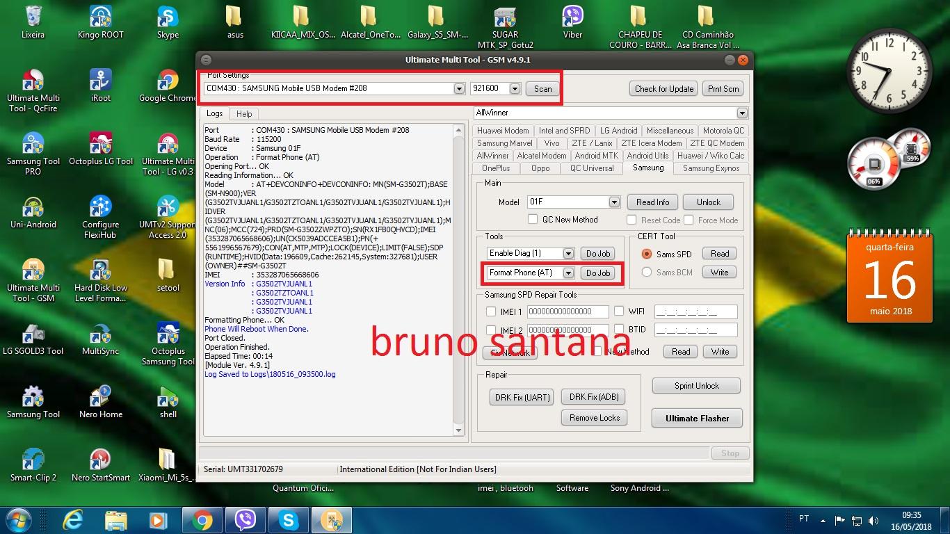

Bruno Santana Postado Maio 16, 2018 Autor Compartilhar Postado Maio 16, 2018 reset samsung g3502t Breno Rodrigues, Reginaldo almeida e AREATECNICACELULAR reagiu a isso 2 1 Citar Link para o comentário Compartilhar em outros sites More sharing options...

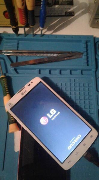

D'zn Info-Cell Postado Junho 9, 2018 Compartilhar Postado Junho 9, 2018 Reparo de boot do aparelho LG D385 Aparelho não ligava, nem mostrava carregando> Operation : Flash Checking for existing devices...Found Port : Qualcomm HS-USB QDLoader 9008 (COM97) Driver Info : HS Corporation, ghsser.sys, 10.2104.1.2 Opening Port...OK Init Handshake Sequence...OK Hardware ID : E1108100 [8x26] 00000000 OPK_DATA : 9CBA94693C2333A562BCF0E0E981C558748817D002F543B2A26AB1B4B3F1CF9E Initializing Protocol...OK Using Auto Loader Selection [1] Preparing Firehose Loader...Done Sending Loader [8x26.ufl]...Done Executing Loader...OK Detecting Chip Type...OK Hardware : 8x10, eMMC, ERASED GPT Payload Info : In: 262144 [4096], Out: 49152, Sector Size: 512 Writing [PrimaryGPT_0.bin] -> [PrimaryGPT] ...Done Writing [modem_8192.bin] -> [modem] ...Done Writing [sbl1_139264.bin] -> [sbl1] ...Done Writing [rpm_141312.bin] -> [rpm] ...Done Writing [tz_142336.bin] -> [tz] ...Done Writing [sdi_143360.bin] -> [sdi] ...Done Writing [aboot_144384.bin] -> [aboot] ...Done Writing [rpmb_148480.bin] -> [rpmb] ...Done Writing [tzb_149504.bin] -> [tzb] ...Done Writing [abootb_150528.bin] -> [abootb] ...Done Writing [persist_204800.bin] -> [persist] ...Done Writing [laf_270336.bin] -> [laf] ...Done Writing [boot_319488.bin] -> [boot] ...Done Writing [recovery_364544.bin] -> [recovery] ...Done Writing [factory_475136.bin] -> [factory] ...Done Writing [sbl1b_581632.bin] -> [sbl1b] ...Done Writing [cust_655360.bin] -> [cust] ...Done Writing [BackupGPT_15268864.bin] -> [BackupGPT] ...Done Resetting device...Done Operation Finished. Module Ver. 2.3 Reginaldo almeida reagiu a isso 1 Citar Link para o comentário Compartilhar em outros sites More sharing options...

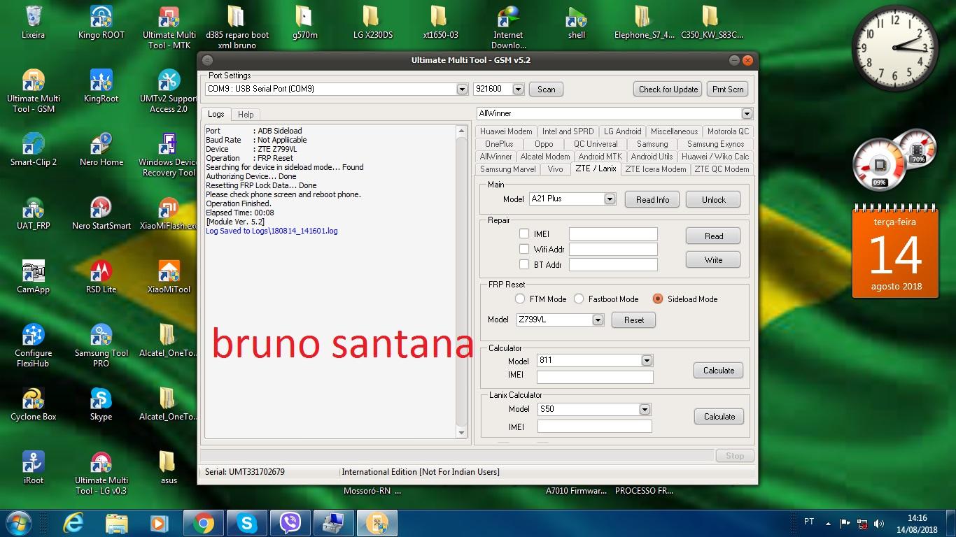

Bruno Santana Postado Agosto 14, 2018 Autor Compartilhar Postado Agosto 14, 2018 reset frp zte z799vl 123adilson, Dr.Software e Reginaldo almeida reagiu a isso 3 Citar Link para o comentário Compartilhar em outros sites More sharing options...

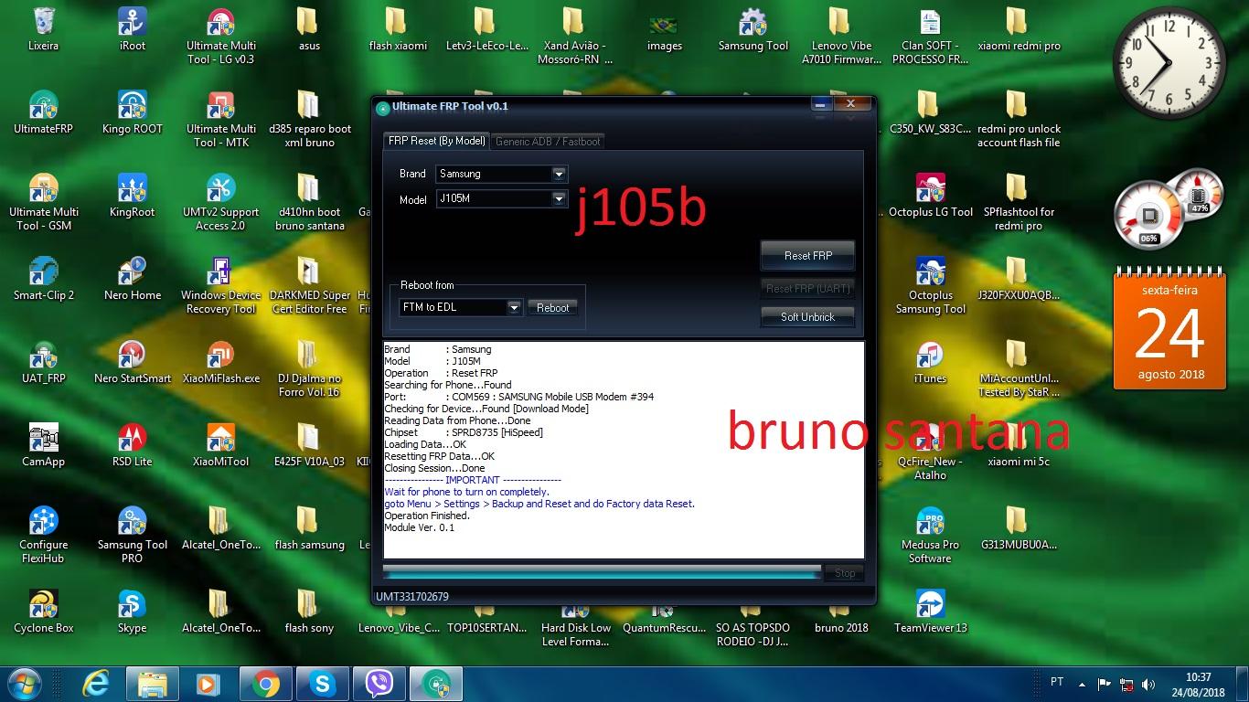

Bruno Santana Postado Agosto 24, 2018 Autor Compartilhar Postado Agosto 24, 2018 frp j105b Claudio Neto, William Ferreira e Emilio cell PE reagiu a isso 3 Citar Link para o comentário Compartilhar em outros sites More sharing options...

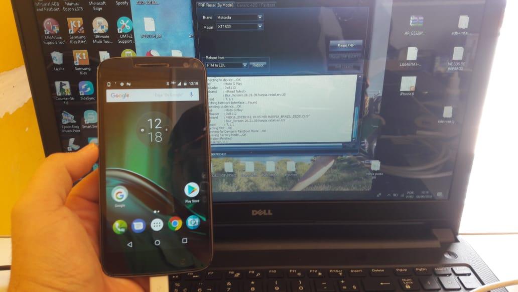

Emilio cell PE Postado Setembro 6, 2018 Compartilhar Postado Setembro 6, 2018 FRP XT1603 MOTOG 4PLAY 100% Reginaldo almeida reagiu a isso 1 Citar Link para o comentário Compartilhar em outros sites More sharing options...
