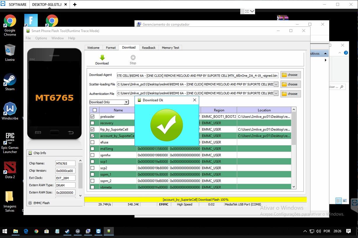

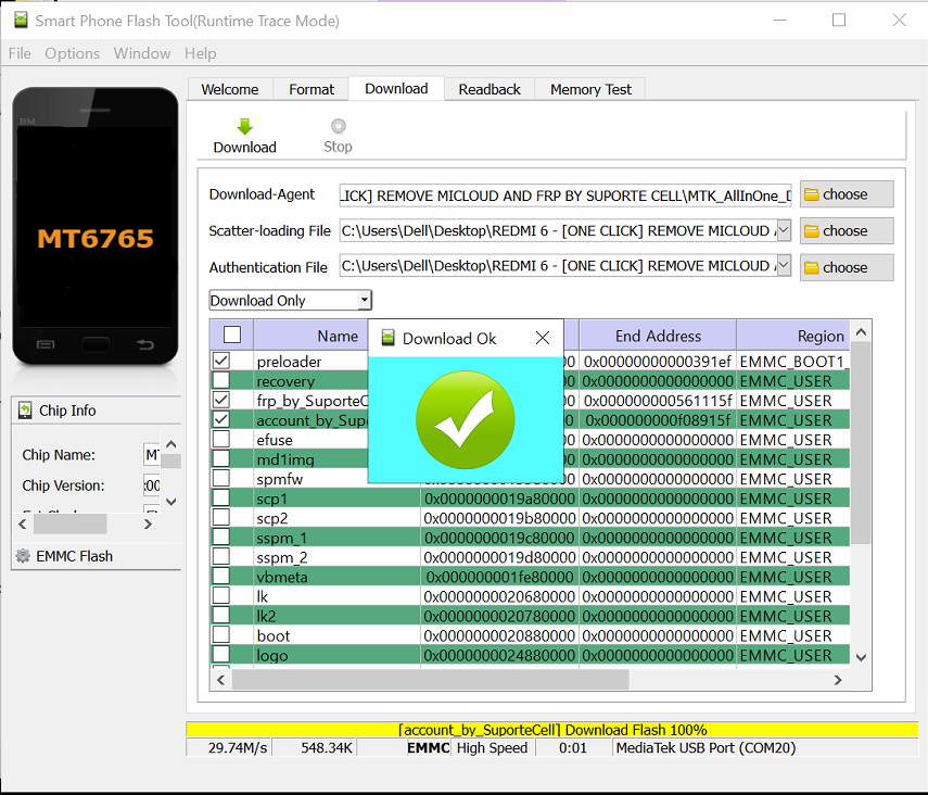

Jesiel Pfeifer Postado Agosto 3, 2019 Compartilhar Postado Agosto 3, 2019 Redmi 6A Mi Accout + FRP + AntiRelock William Ferreira e GSRFIX reagiu a isso 2 Citar Link para o comentário Compartilhar em outros sites More sharing options...

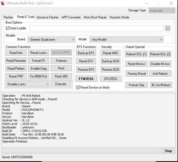

William Ferreira Postado Agosto 3, 2019 Compartilhar Postado Agosto 3, 2019 Restore EFS Redmi Note 7 Baseband unknow Operation : Restore EFS Checking for existing devices...Not Found Turn Off phone, hold Vol UP + Vol DOWN and insert USB cable. Some phones may need Special Boot Cable or TestPoint for EDL mode. Found Port : Qualcomm HS-USB QDLoader 9008 (COM20) Driver Info : Qualcomm Incorporated, qcusbser.sys, 2.1.0.5 Connecting to phone...OK Waiting for response...OK Init Handshake Sequence...OK Hardware ID : E1C00800 [8996] 00000000 OPK_DATA : F7337FE47B192EF4D1BA34CB4E879F0C6B771D06D2DE87BF21F65BA3303834E1 Initializing Protocol...OK Using Auto Loader Selection [1] Preparing Loader...Done Sending Loader [8996_022]...Done Executing Loader...OK Detecting Chip Type...OK Hardware : MSM8996, eMMC, 64 GB LU Count : 1 [0x0747C000] WARNING! High Speed Driver is not installed. Please install driver from QcFire\Drivers folder using Device Manager. Payload Info : In: 65536 [4096], Out: 131072, Sector Size: 512 Reading Partition Table...OK Reading Device Information...OK Device : Xiaomi Redmi Note 7 [lavender] Software : PKQ1.180904.001, V10.3.6.0.PFGMIXM [Tue Jun 18 01:04:48 WIB 2019] Android Ver. : 9 Patch Level : 2019-05-05 Backup File : EFS_Xiaomi_Redmi Note 7_PKQ1.180904.001_2019-02-05_190517_144130.ueb Restoring EFS.......Done Operation Finished. QcFire Ver. 4.6 Jesiel Pfeifer reagiu a isso 1 Citar Link para o comentário Compartilhar em outros sites More sharing options...
William Ferreira Postado Agosto 3, 2019 Compartilhar Postado Agosto 3, 2019 Reset FRP Redmi Note 5 Operation : Reset FRP Checking for existing devices...Not Found Turn Off phone, hold Vol UP + Vol DOWN and insert USB cable. Some phones may need Special Boot Cable or TestPoint for EDL mode. Found Port : Qualcomm HS-USB QDLoader 9008 (COM19) Driver Info : Qualcomm Incorporated, qcusbser.sys, 2.0.8.7 Connecting to phone...OK Waiting for response...OK Init Handshake Sequence...OK Hardware ID : E1C00C00 [8996] 00000000 OPK_DATA : F7337FE47B192EF4D1BA34CB4E879F0C6B771D06D2DE87BF21F65BA3303834E1 Initializing Protocol...OK Using Auto Loader Selection [1] Preparing Loader...Done Sending Loader [8996_016]...Done Executing Loader...OK Detecting Chip Type...OK Hardware : MSM8996, eMMC, 64 GB LU Count : 1 [0x0747C000] WARNING! High Speed Driver is not installed. Please install driver from QcFire\Drivers folder using Device Manager. Payload Info : In: 65536 [4096], Out: 131072, Sector Size: 512 Reading Partition Table...OK Reading Device Information...OK Device : Xiaomi Redmi Note 5 Software : OPM1.171019.011, V10.0.2.0.OEIMIFH [Mon Oct 8 19:41:43 WIB 2018] Android Ver. : 8.1.0 Patch Level : 2018-09-01 Resetting FRP Lock.......Done Operation Finished. QcFire Ver. 4.6 Citar Link para o comentário Compartilhar em outros sites More sharing options...

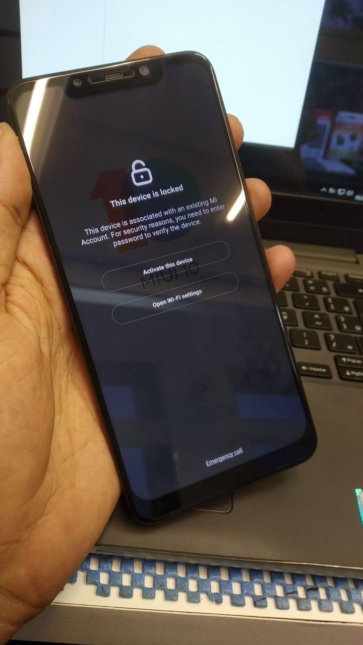

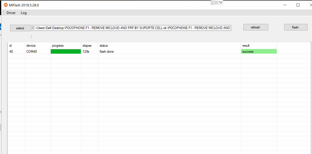

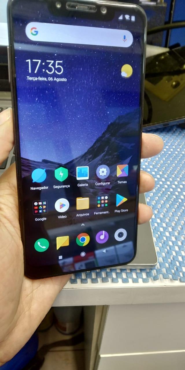

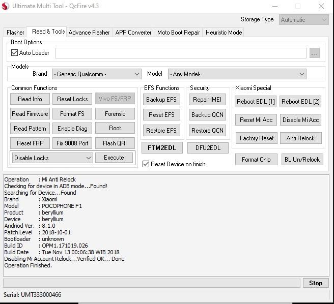

Jesiel Pfeifer Postado Agosto 6, 2019 Compartilhar Postado Agosto 6, 2019 (editado) Pocophone F1 FRP + Mi Account com login autenticado via remoto para o colega @willkabral Editado Agosto 8, 2019 por Jesiel Pfeifer William Ferreira, ThiagoMonteiro, Fbkeltenner2 e 1 outro reagiu a isso 2 2 Citar Link para o comentário Compartilhar em outros sites More sharing options...

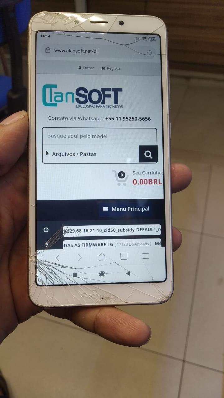

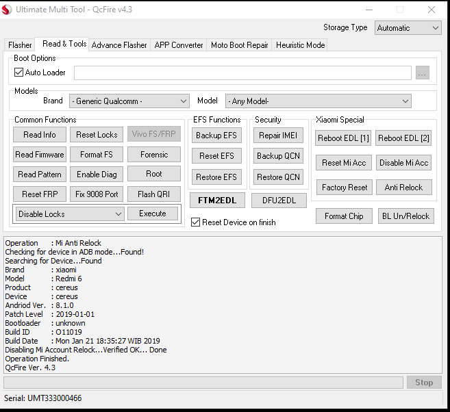

Jesiel Pfeifer Postado Agosto 8, 2019 Compartilhar Postado Agosto 8, 2019 Redmi 6 FRP + Mi Account com login autenticado via remoto para o colega @willkabral Parceria TOP! willkabral, 123adilson e Fbkeltenner2 reagiu a isso 1 2 Citar Link para o comentário Compartilhar em outros sites More sharing options...

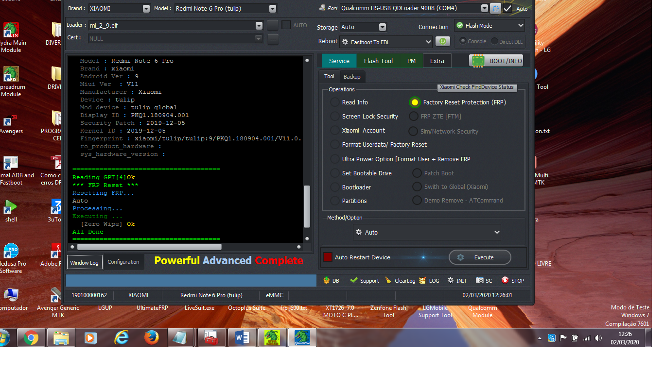

DADACEL CELULARES Postado Março 3, 2020 Compartilhar Postado Março 3, 2020 FRP Xiaomi Redmi Note 6 Pro via hydra Qualcomm com Sucesso ! Hydra Qualcomm Tool Ver 1.0.1 Build 62 Windows 7 Service Pack 1 (Version 6.1, Build 7601, 64-bit Edition) Intel(R) Core(TM) i5-4200U CPU @ 1.60GHz Intel(R) HD Graphics Family Ram Installed : 4 GB Windows Access Right Admin Software Run As Admnistrator ******* Dongle Info ******* Version : Hydra Tool v 1.1 Serial : 190100000162 Initialize : OKAY Status : Activated Life : 0-[0-0-0-0-0] PreOperation Configuration Brand : XIAOMI Model : Redmi Note 6 Pro (tulip) Storage : Auto Loader: mi_2_9.elf Port : Auto Connection : Flash Mode Finding EDL Port..[COM4] Getting device info....... Serial No.: 0x14E916CB MSM ID : 0x000CC0E1 PBL Ver : 00000004 PK HASH : A7B8B82545A98ECA23D6E9105FB46456 8D1B5828264903441BDEF0CD57E3C370 Firehose Loader[mi_2_9.elf] Initializing SaharaBoot... Ok Sending ...............................Ok Finding EDL Port..[COM4] Connecting to Firehose... Ping...... Ok Configuration...... Identifying Chip....Ok Chip Configuration : MemoryName : eMMC MaxPayloadSizeToTargetInBytes : 8192 MaxPayloadSizeToTargetInBytesSupported : 8192 MaxPayloadSizeFromTargetInBytes : 4096 MaxXMLSizeInBytes : 4096 TargetName : MSM8996 Version : 1 DateTime : Aug 2 2018 - 22:27:53 *** STORAGE DEVICE INFO *** Memory Type : eMMC Block Size in Bytes : 512 Page Size : 512 Manufacturer ID : 19 Serial Number : 162833381 Firmware Version : 4 Product Name : S0J9D8 Physical Partitions : 4 Total Logical Blocks: Drive [0] 122142720[58,242 GB] Drive [1] 8192[4 MB] Drive [2] 8192[4 MB] Drive [3] 8192[4 MB] Running : Ok Reading GPT[4]Ok Phone Information..... Model : Redmi Note 6 Pro Brand : xiaomi Android Ver : 9 Miui Ver : V11 Manufacturer : Xiaomi Device : tulip Mod_device : tulip_global Display ID : PKQ1.180904.001 Security Patch : 2019-12-05 Kernel ID : 2019-12-05 Fingerprint : xiaomi/tulip/tulip:9/PKQ1.180904.001/V11.0.2.0.PEKMIXM:user/release-keys ro_product_hardware : sys_hardware_version : ====================================== Reading GPT[4]Ok *** FRP Reset *** Resetting FRP... Auto Processing... Executing ... [Zero Wipe] Ok All Done ====================================== Elapsed Time : 00:00:15 Citar Link para o comentário Compartilhar em outros sites More sharing options...
