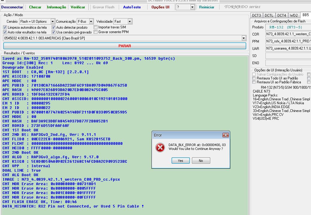

SandroAlves Postado Outubro 5, 2011 Postado Outubro 5, 2011 Olá amigos estou com um n73 que acusa este erro na hora de fazer a flash pela mxkey: Supported Ids: 17100700, 17100701, 17100702, 17100703, 17100704, 17100708 Read Certificate failed. NPC_DATA is empty. SUPERDONGLE_KEY_DATA saved OK CMLA_KEY_DATA saved OK RF_DATA saved OK WARRANTY_DATA saved OK PROD_DATA saved OK BT_DATA saved OK LOCK_DATA saved OK BB_DATA saved OK RPL saved to ".rpl" Processing MCU file: N73_4.0839.42.1.1_western_C00_PRD_cc.fpsx [bB5,BB5 ALGORITHM,BB5,OMAP1710 UNISTORE-II-1.2.1 ALG] size: 46.23 MB Supported Ids: 0103192101013000, 010C192101013000, 0003192101012200, 000C192101012200 Supported Ids: 17100708 APE Data : SYSTEM ASIC ID: 17100708 [OMAP1710 ver: 2.0] ASIC MODE ID: 00 PUBLIC ID: 70130CA71666DA223AF6C91BA097D049867F625B ROOT KEY HASH: 49A97E826B93BA20B7ED0B082475C00500000000 ROM ID: 1DFD66132C872FD4 CMT Data : SYSTEM ASIC ID: 000000010000022600010006010C192101013000 EM0 ID: 00000295 EM1 ID: 00000B22 PUBLIC ID: 07000107747A0254148DF211D0F8330950CB59D5 ASIC MODE ID: 00 ROOT KEY HASH: BAF3A9C3DBFA8454937DB77F2B8852B1 ROM ID: 273F6D55DFAAF68F SecondaryBoot: RAP3Gv3_2nd.fg [bB5] version: 1.30.0 revision: 0.0 size: 0x3C00 Supported Ids: 0103192101003000, 010C192101003000, 0103192101013000, 010C192101013000, 0103192101003100, 010C192101003100, 0303192101023000, 030C192101023000, 0303192101033000, 030C192101033000, 0103192101001101, 010C192101001101, 0003192101001002, 000C192101001002, 0013192101001002, 001C192101001002 eBB5ProtocolType: OLD Storage0: 00EC 22E8 - 0000 6921 [samsung K8S2815ETB,128 Mbits] type: FLASH,NOR, asic:CMT Storage content: 0000 0000 0000 0000 0000 0000 0000 0000 Storage1: FFFF 0000 - 0000 0000 type: MMC, asic:CMT TransmissionMode: 16Bit Algorithm: RAP3Gv3_algo.fg [bB5 ALGORITHM] version: 1.40.0 revision: 0.0 size: 0x22C10 Supported Ids: 0103192101003000, 010C192101003000, 0103192101013000, 010C192101013000, 0103192101003100, 010C192101003100, 0303192101023000, 030C192101023000, 0303192101033000, 030C192101033000, 0003192101002000, 000C192101002000, 0003192101002100, 000C192101002100, 0003192101002200, 000C192101002200, 0003192101012200, 000C192101012200, 0103192101001101, 010C192101001101, 0003192101001002, 000C192101001002, 0013192101001002, 001C192101001002 CMT PAPUBKEYS HASH: 5E8D0D504A0902E261268C14FCD8A2C9093523BC TransmissionMode: DDR&TX2 SecondaryBoot: helen3_2nd.fg [bB5] version: 1.35.0 revision: 0.0 size: 0x3500 Supported Ids: 17100700, 17100701, 17100702, 17100703, 17100704, 17100708 Task failed at (08000006)!!! Last RX buffer: 04 00 00 00 00 B1 72 ou esse erro na hwk (Versão do software está aqui MCU SW : V 05wk47v51.4 29-08-07 RM-132 © Nokia. APE Core: V 4.0738.3.1.1 18-09-2007 RM-132 APE Var : V 4.0738.3.1 .1-H6 18-09- 2007 RM-132 e o erro está aqui na imagem: a versão da flash que estou tentando colocar é está.: COR: N73_4.0839.42.1.1_western_C00_PRD_cc.fpsx PPM: N73_rofx_4.0839.42.1.1_PRD.VG2 UAR: N73_userarea_4.0839.42.1.1.U27 Agradeço desde jah pela ajuda. Citar
Felipe Pessoa Postado Outubro 5, 2011 Postado Outubro 5, 2011 Olá amigos estou com um n73 que acusa este erro na hora de fazer a flash pela mxkey:Supported Ids: 17100700, 17100701, 17100702, 17100703, 17100704, 17100708Read Certificate failed.NPC_DATA is empty.SUPERDONGLE_KEY_DATA saved OKCMLA_KEY_DATA saved OKRF_DATA saved OKWARRANTY_DATA saved OKPROD_DATA saved OKBT_DATA saved OKLOCK_DATA saved OKBB_DATA saved OKRPL saved to ".rpl" Processing MCU file: N73_4.0839.42.1.1_western_C00_PRD_cc.fpsx [bB5,BB5 ALGORITHM,BB5,OMAP1710 UNISTORE-II-1.2.1 ALG] size: 46.23 MBSupported Ids: 0103192101013000, 010C192101013000, 0003192101012200, 000C192101012200Supported Ids: 17100708APE Data :SYSTEM ASIC ID: 17100708 [OMAP1710 ver: 2.0]ASIC MODE ID: 00PUBLIC ID: 70130CA71666DA223AF6C91BA097D049867F625BROOT KEY HASH: 49A97E826B93BA20B7ED0B082475C00500000000ROM ID: 1DFD66132C872FD4CMT Data :SYSTEM ASIC ID: 000000010000022600010006010C192101013000 EM0 ID: 00000295EM1 ID: 00000B22PUBLIC ID: 07000107747A0254148DF211D0F8330950CB59D5ASIC MODE ID: 00ROOT KEY HASH: BAF3A9C3DBFA8454937DB77F2B8852B1ROM ID: 273F6D55DFAAF68FSecondaryBoot: RAP3Gv3_2nd.fg [bB5] version: 1.30.0 revision: 0.0 size: 0x3C00Supported Ids: 0103192101003000, 010C192101003000, 0103192101013000, 010C192101013000, 0103192101003100, 010C192101003100, 0303192101023000, 030C192101023000, 0303192101033000, 030C192101033000, 0103192101001101, 010C192101001101, 0003192101001002, 000C192101001002, 0013192101001002, 001C192101001002eBB5ProtocolType: OLDStorage0: 00EC 22E8 - 0000 6921 [samsung K8S2815ETB,128 Mbits] type: FLASH,NOR, asic:CMT Storage content: 0000 0000 0000 0000 0000 0000 0000 0000 Storage1: FFFF 0000 - 0000 0000 type: MMC, asic:CMT TransmissionMode: 16BitAlgorithm: RAP3Gv3_algo.fg [bB5 ALGORITHM] version: 1.40.0 revision: 0.0 size: 0x22C10Supported Ids: 0103192101003000, 010C192101003000, 0103192101013000, 010C192101013000, 0103192101003100, 010C192101003100, 0303192101023000, 030C192101023000, 0303192101033000, 030C192101033000, 0003192101002000, 000C192101002000, 0003192101002100, 000C192101002100, 0003192101002200, 000C192101002200, 0003192101012200, 000C192101012200, 0103192101001101, 010C192101001101, 0003192101001002, 000C192101001002, 0013192101001002, 001C192101001002CMT PAPUBKEYS HASH: 5E8D0D504A0902E261268C14FCD8A2C9093523BCTransmissionMode: DDR&TX2SecondaryBoot: helen3_2nd.fg [bB5] version: 1.35.0 revision: 0.0 size: 0x3500Supported Ids: 17100700, 17100701, 17100702, 17100703, 17100704, 17100708Task failed at (08000006)!!!Last RX buffer: 04 00 00 00 00 B1 72 ou esse erro na hwk (Versão do software está aqui MCU SW : V 05wk47v51.4 29-08-07 RM-132 © Nokia. APE Core: V 4.0738.3.1.1 18-09-2007 RM-132 APE Var : V 4.0738.3.1 .1-H6 18-09- 2007 RM-132 e o erro está aqui na imagem:a versão da flash que estou tentando colocar é está.:COR: N73_4.0839.42.1.1_western_C00_PRD_cc.fpsx PPM: N73_rofx_4.0839.42.1.1_PRD.VG2 UAR: N73_userarea_4.0839.42.1.1.U27Agradeço desde jah pela ajuda.Sr. Me parece que você esta tentando aplicar uma versão de software inferior a do aparelho.Teste com a versão mais alta disponível. Citar

Felipe Pessoa Postado Outubro 7, 2011 Postado Outubro 7, 2011 Faça novamente o procedimento o post um novo print completo, pois o que você postou esta incompleto. Faça o teste com outro cabo pois no print que você postou esta dando um erro no pino RX do cabo. Verifique oxidação no cabo ou nos contatos da p.c.i do aparelho. Citar
